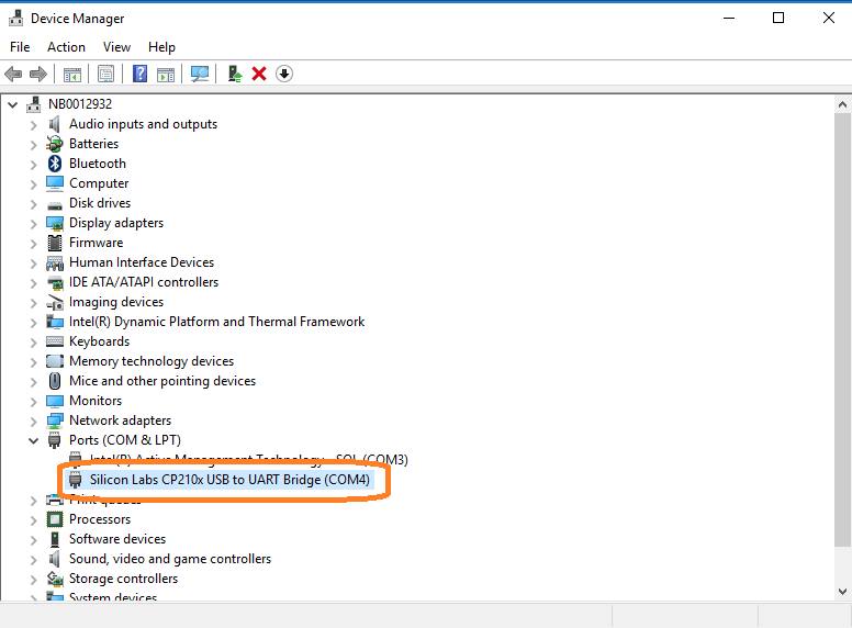

If your printer still doesn’t connect, it might need a little more diving deep into the issue. Install Termite from this link https://termite.software.informer.com/download. and open it.
Find out the com port address of your printer (CP210x) which looks like COM11, COM4 etc, from the devices manager and open termite on that port with default settings and baud rate of 250000. Press connect and restart Markhor3D by pressing the restart button on the ESP32 module.
The printer should throw back some readable diagnostic data in addition to some garbage characters on the terminal. In the Termite command window, Enter “M115” and hit enter. It should through back the firmware status of your printer. It just proves that the printer can communicate both ways with your PC.
