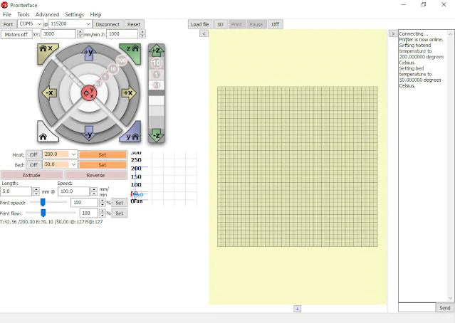

It is important that you also tell prontoface the printer dimensions. In Prontoface setting.
So you can control the speed of movement of individual sliders and command them to move in a particaular direction quite easily.
Most of the features that you need are already here on the GUI
Movement (The joypad)
Homing (Home Icons)
Speed Control (Top of the panel)
Hotend Control
Extruder Pull and Push with controlled speed and extent
Turn off all motors
